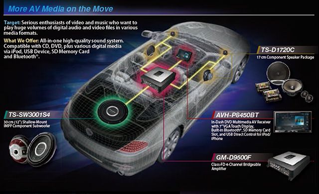

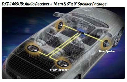

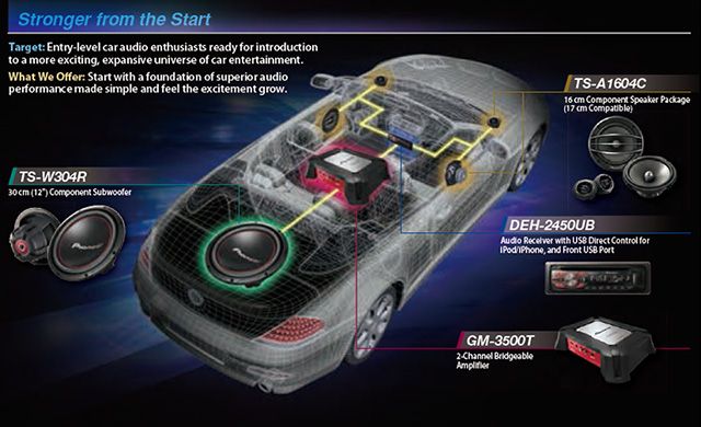

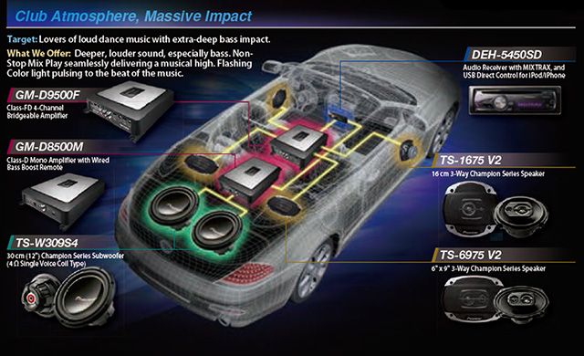

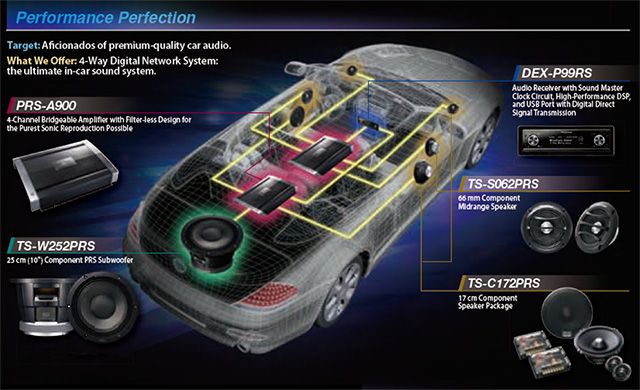

    The gears that you would use depends on the over-all sound that you are after. Here are some sample configurations from Pioneer.
