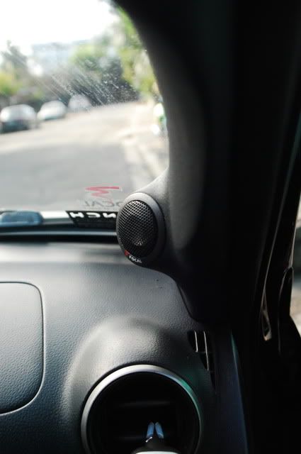

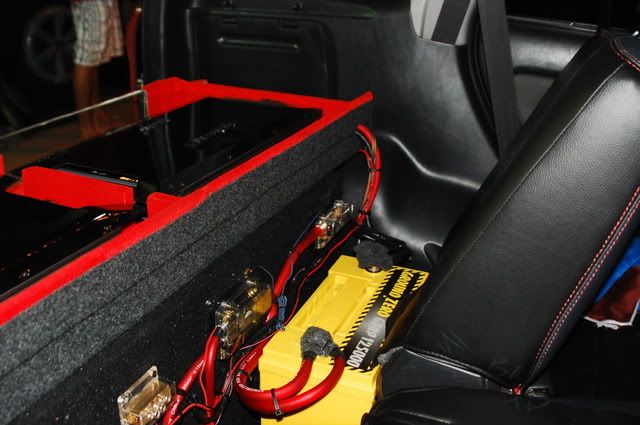

    Happy New Year! Buhayin natin itong thread. Posting my car setups, SQ and SPL.
    4th-gen CRV
    [/url]

    Quote Originally Posted by sientobente View Post
    4th-gen CRV
    [/url]
    That CRV looks familiar. ;)
    Pa audi naman sir. Same tayo installer hehe

    #1449
    Quote Originally Posted by Chriswhiz View Post
    Sure thing Sir Ganda nga ng gawa ni Jonz.
