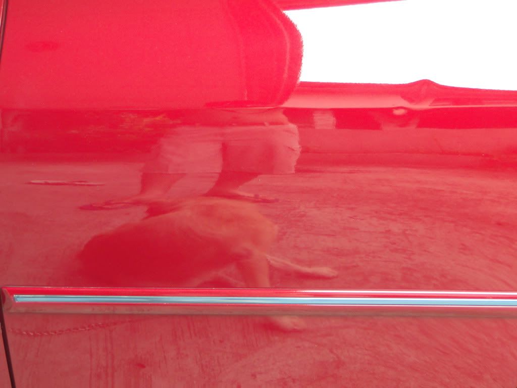

    Quote Originally Posted by Ginnova View Post
    Guys, salamat sa pag-accomodate nyo sa amin kanina. Sa susunod na seminar ulit. Yung secret formula ni master ( Med's 69 ba o Yakult ) ano ba laman nun?
    Eto pala resulta.
    Great job! i think you're the one my BF told me did a spectacular job using SwirlX by hand and finished it out like you used a PC. Great job! Not everyone gets great results with SwirlX via hand application and some even have a hard time finishing with it.

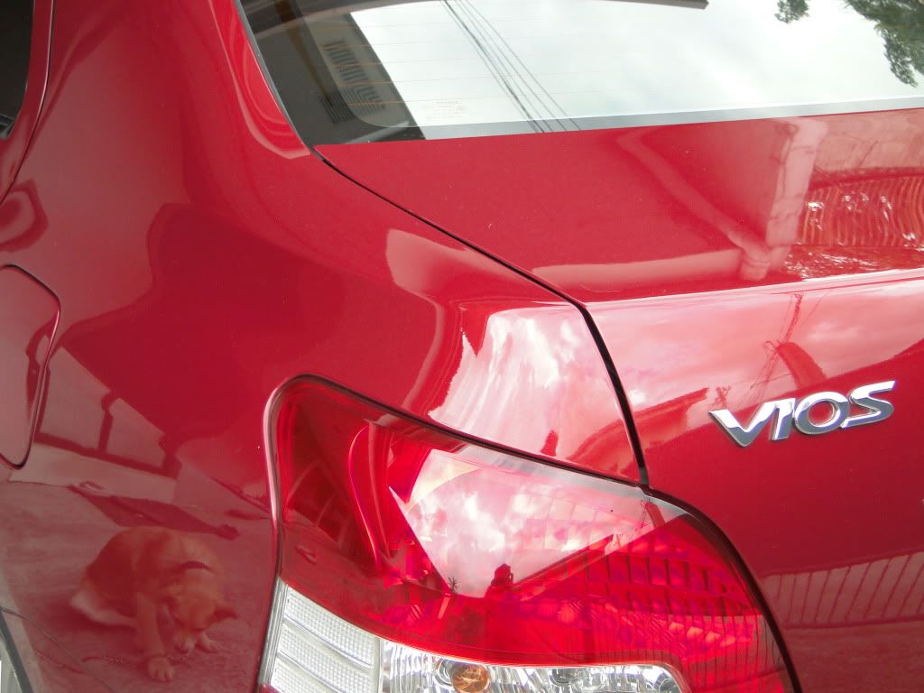

    Quote Originally Posted by electone View Post
    Hi, fellow detailing addicts! Just want to share results of Zaino. I put on 3 layers Z5, 3 layers Z2, then topped with Z8. Done in a span of two weeks.
    Thats a damn good detail right there! Those are some really great results and shots on the hood, i love how sharp and clear they are and i love the depth, i guess thats why Zaino is on our Top 5 Sealants list, and i also give you credit for properly preparing the paint, Zaino would be useless on a poorly prepped paint, and thats one well prepped paint!
    BTW did you use ZFX on those multi layers?
