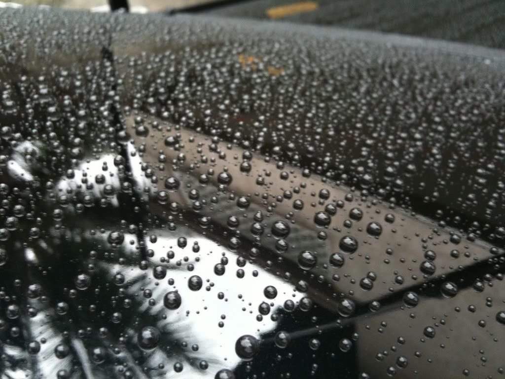

    mega detailing Sunday for me... clay - Step 1 - NanoGlos - 476 - tapos umulan..
    before rain...
    beading after rain
    then i put nanosliq this morning... hayop sa beading lalo!!! I left my car at my office's open parking area... ayun naulanan...
    I went home at midnight, drove at 80kph... pag uwi ko, almost dry na! just used plush MF to completely dry... halos moist lang ung MF! ayus! daig pa nung pagka-moist ng ultra plush when i apply nano-sliq!

    Quote Originally Posted by rico_g View Post
    before rain...
    beading after rain
    nice job!
    WOW those are really tight water beading, they already look like small bearings its so nice to look at, its really cute when you see beads that small and round and then drive around and just see them fly off the paint hehehe
