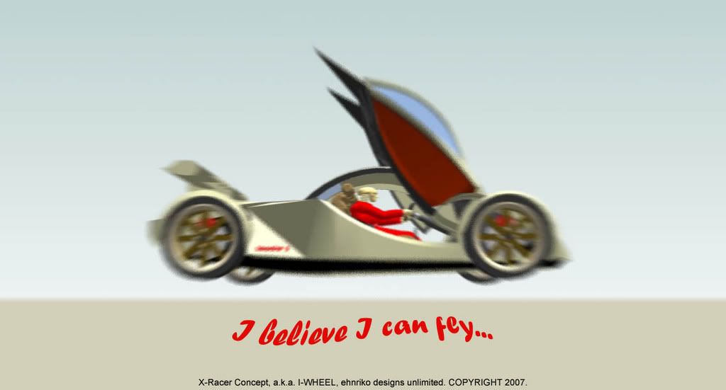

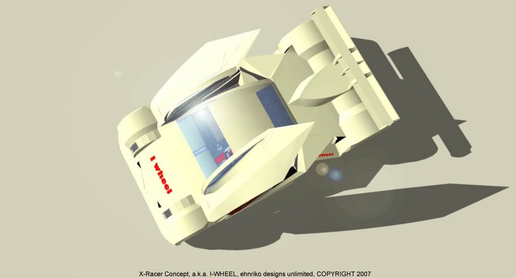

    i wonder how will you have doors in the car? ... from the images, the car's "shoulder" is too thick to have a standard door unless it swings up like a lambo.
    Next is the rear area seems too low and small to have a Camry sized engine fitted there. Maybe a Honda B16 engine (in a mid-engine RWD config) would fit.
    ghosthunter has valid points there. So, perhaps it's time to do a bit of "nip-tuck" on your wireframe model, ehnriko. And maybe we should also hear from wildthing, the thread starter. Any comments?

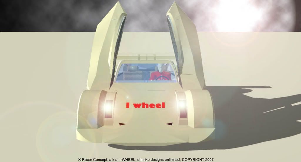

    kaya yan sa frp and the design seems very fit....
    lambo-like doors or a door the pushes outward (hydrolics) before turning outwards or ala-lambo.
    kulang pa rin ako ng specs hehehe

    Quote Originally Posted by mbeige View Post
    Why do I remember the Pagani Zonda when I see your design?
    All mid engined cars have similar silhouettes... but a trained eye can the see the difference... they all have different design signatures... you can start by checking the theme they use on the face, fenders, windshields and muscle sculptures... (Pagani Zonda is more similar to the Mclaren F1)
    X-Racer is a minimalistic sports car... the fender muscles intend to provide an optical illussion to make up for the thinner wheels installed to it. Most supercars need to have Wider Wheels in order to look good. the X-Racer is comfortable with Motorcycle Wheels or even your standard 19 inch x 7 inch mags.
    This is a concept that aims to place the Pinoy shoulder to shoulder in terms of form or styling against the Italians or Americans, with a sports car that's only a fraction of the cost compared to their Hi-valued Supercars...
    It took me about 8 hours to conceptualize this and about 6 hours to render in 3D... another 3 hours to render the doors just now... and about 30 minutes transferring to JPEG files.
    I'll post the other elevations view later on. Anyway, this is just a design exercise for me... I don't think anyone is serious enough in making a Pinoy Sports Car... is there???
