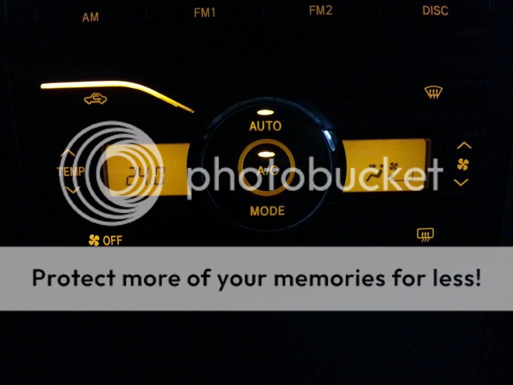

    This is how it looks like now when I turn on the aircon. It's just one bar.
    It used to be full bars then it gradually decreases to one bar as it reaches my temperature setting. Now it's always just one bar And I swear that the aircon feels hilaw

    I cant view your pic, server too strict here in the office. I'll check it out later. Does your AC have manual recirculate mode? Try manually setting it to your desired temp on recirculate mode. See what happens.

    Ok, I see your photo, have you tried lowering the temp setting? Does it have to be on 24 Lang? And try not putting it in auto.
