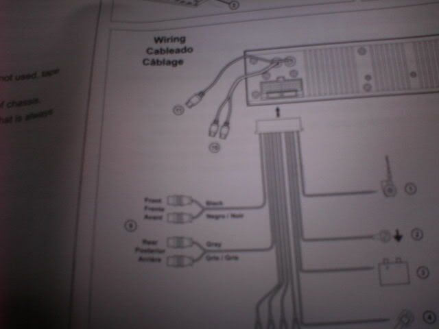

    manila na ko edwin, bali 1 set RCA for front, 1 set RCA for rear, and 1 pc RCA for sub, and 1 set for input pa....
    the 1st rca is the sub out, the 2nd set are the input RCA's, the 2 below ang pang front and rear channel....thanks sa tulong nyo ha..

    kung di ka naman gamit ng rear chanel yung na lang gamitin mo ma sub out(just like mine). pero kung may sub control ang HU mo try mo subukan yung 1 prc RCAsubout. bili ka nag y-connector to split the single rca papunta sa L+R input ng amp(btw, ano amp and sub mo?). i assume bridgable to mono ang amp mo kasi mono lang din ang signal mo. some say just connect your sub out to the left channel of your amp(di ka na bili nag y-connector). wala naman ako kita problema dito. HTH.

    Sound Guru's, How do I connect my ampli to my HU if my HU doesn't have a RCA pre out? Amp is V12 1507. Thanks!
    Apr 2005
    197
    #500
    Quote Originally Posted by ching
    speaker output front channel
    connect to rca cord use white for left channel and red for right channel
    positive terminal is the inner part of the rca plug +(pointed head) ,outer part is the negative -(outer ring)
