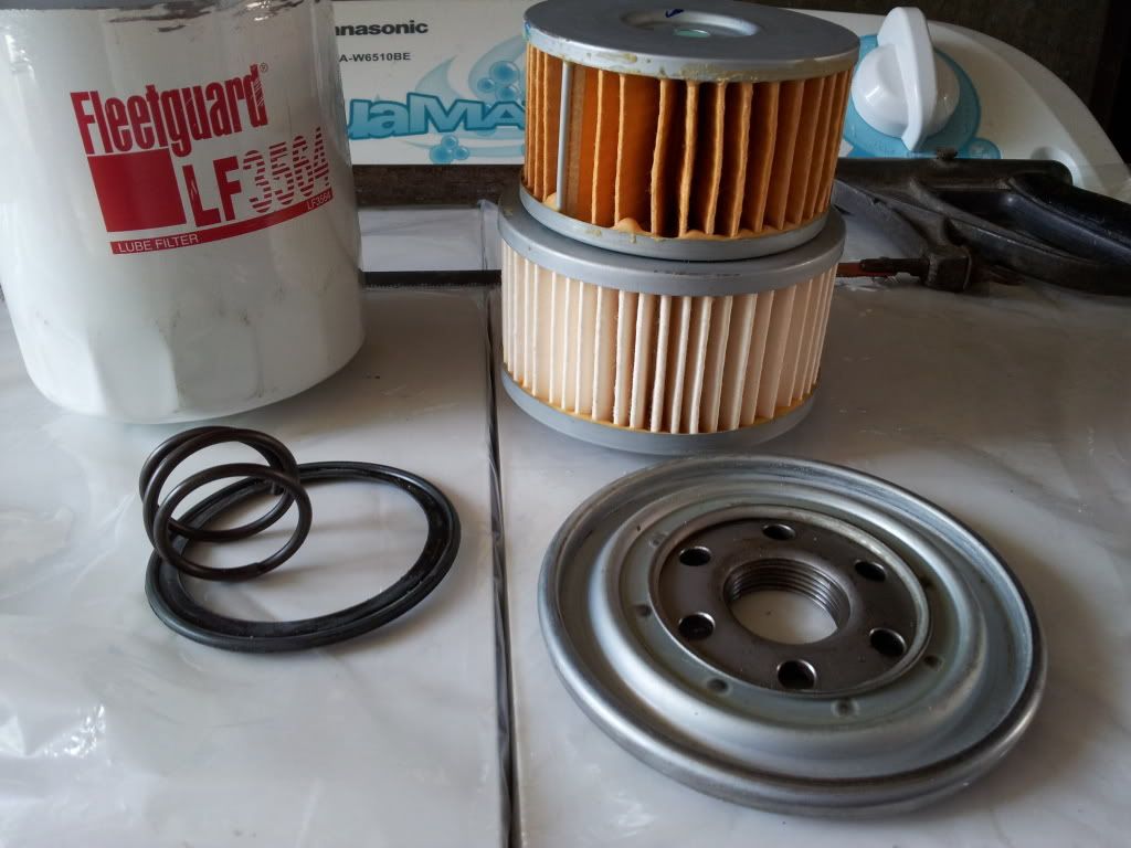

    Well here's what Fleetguard sent me.
    CSSPI has been purchasing LF3564 made in Malaysia since Feb 2008 So far, there has been no quality issue raised.
    Pictures attached. LF3564 as shown below has been supplied by Cummins Filtration since YR2004 from source in Malaysia. All Fleetguard products will always meet or exceed OE specifications and they are covered under Fleetguard global warranty.
    I would like to visit those customers of CSSPI who are confused by this issue and I will address them in person for my next trip to Philippines
    Anyone who has a questionable filter they would like to be contacted, Pics and a invoice of purchase helps out a lot.
    These are the photos they sent of the filter.
    Now here is the one posted from W&L on this forum. Not the same filter in my opinion, and if it is the quality is crap.
    I would only purchase them with the country of origin on the filter because these South east Asia filters are defiantly not that impressive. Not it's still fully wrapped in plastic, the ones with with the plastic at the bottom only should be completly avoided (they never have a country on them)
    The BD28 is a far superior filter than this one, way more pleats and more filter surface.
    25,108
    One thing I noticed is that the orig Fleetguard has the markings going up the can while the fake one has markings going down into the bottom where the oil goes thru. Definitely two different filters.
