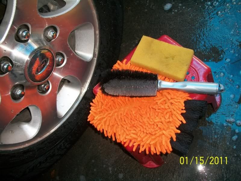

    6)Cleaning the Mags and wheelwells
    i.Materials
    ~ACE washmitt, Mr. Clean tirebrush, sponge
    *You will most probably still have shampoo+water mix leftover from cleaning the body. Otherwise, make another, smaller batch.
    ii. Washmitt for the mags. Remember to clean in between the spokes.
    iii. Tirebrush
    iV. Sponge for the wheelwell plastics
    Q:Why a sponge?
    A:A brush will scratch the plastic parts of the wheelwells. But a brush is fine on the other areas.
    *REMEMBER: shampoo-surface-rinse-shampoo still applies here. Expect the rinse water to turn pitch black by this time.

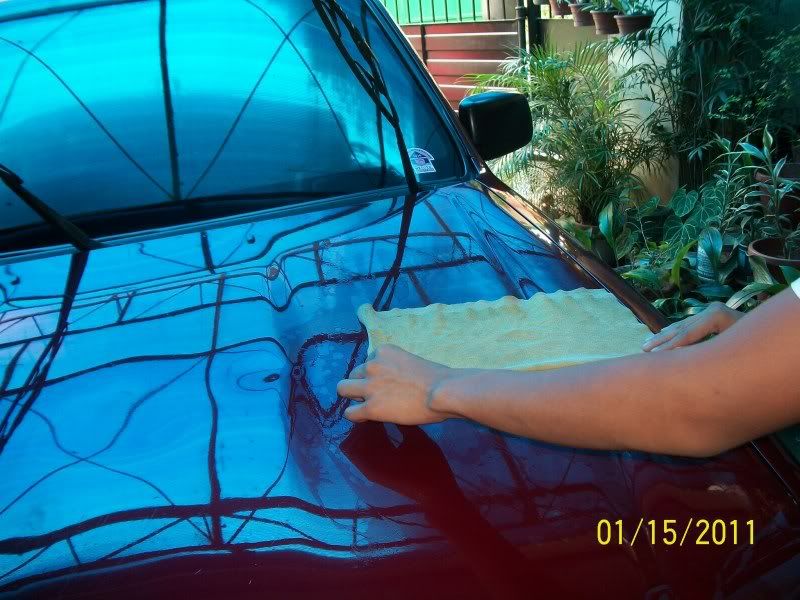

    ii. flood the areas with smooth-flowing water from a hose. In waxed cars, this will significantly decrease the amount of water left on the surface
    iii. Fold the (microfiber)chamois/drying cloth, and let its weight drag it across the surface for the horizontally-oriented panels
    Jun 2007
    2,840
    iV. For the side-panels, Apply light pressure - enough only to press it lightly against the surface) whilst dragging it along
    *NOTE: if it squeaks, check if the microfiber is dirty. Use another side if possible.

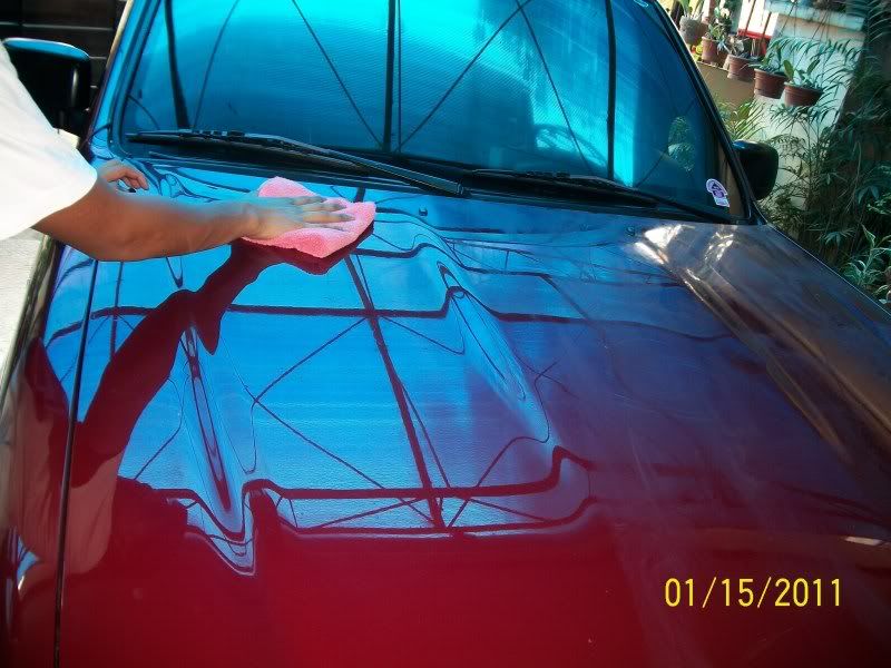

    3) Microfiber cloths (Microtex)
    Terry (orange, P120), Plush (pink P200), Ultra Plush (green ~P250)
    the Terry is ideal for applying QDs and drying surfaces
    the Plush and Ultra Plush are ideal for buffing off waxes and QDs
    *NOTE: the MF cloths were folded twice to give 8 buffing surfaces to work with.

    3)Allow wax to dry on panel, then test using the "Finger Test" as described above
    4)Buff off wax using a linear motion
    Q:Why linear?
    A: see explanation for applying it in a linear fashion
    Repeat steps 2-4 for all the other panels.
    5)Buff off any residue.
