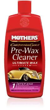

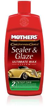

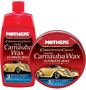

    Yung Mothers 3 step system tatlong product siya.
    This is the foundation of the Ultimate Wax System®, preparing your paint for Sealer & Glaze and Pure Carnauba Wax. Pre-Wax Cleaner removes oxidized paint, old wax buildup and other contaminants, cleaning and shining your paint. This mild polish smoothes the edges of larger imperfections and removes small scratches. Your paint’s appearance is dependent on a good polishing — Mothers® Pre-Wax Cleaner should be used at least once or twice a year.
    Regular application of Mothers® Sealer & Glaze will increase your paint’s depth and luster. Whatever the color, it will give your paint added character and a brilliant, glowing shine. Sealer & Glaze fills and hides minor swirls and defects, minimizing unsightly visual imperfections. It also contains a super-fine polish that further improves the paint surface. Sealer and Glaze is key to giving both light and dark colors their perfect finish.
    This is the final step on the path to a beautiful finish. Mothers® Pure Carnauba Wax is made with the finest Brazilian #1 yellow carnauba for superior shine and protection. It is non-abrasive, so use it as often as you like. You can apply more than one coat to keep your efforts well protected. For unsurpassed shine, depth and protection, trust Mothers® Ultimate Wax System®.
