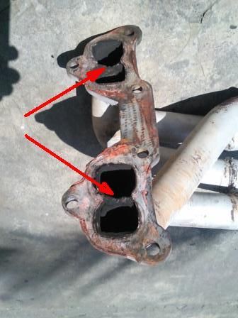

    Before proceeding wrapping my Mandrel |Bent header 421. I have to send it o welder to fill up gap between 2 pipes. Mufflerland made a very poor job and also port holes of cylinder head and header plate hole was not properly aligned. I have to grind off the header hole to correct the alignment of holes.
    Picture of poor quality work of header with gap.
    I have to grind off mark with white paint that was misaligned portion of header plate holes. Almost all 4 holes have obstruction.
    Finished DIY repair and wrapping of my Header

    My engine now runs quietly and engine vibration was greatly reduced. My vacuum gauge reads 10 hmg when accelerating instead of 0-5hg.This means engine have better performance. Probably due to correction or alignment of engine exhaust port hole to header and exhaust gases now flow freely.
    My only problem now was that exhaust pipe was too hot. Smoke was emitted in my muffler due to burning of previous oil deposit from my loose compression engine.
